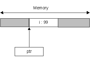

We already know that C implements arrays by means of pointers. This means that I can de-reference a pointer by putting a subscript after it:
ptr[0] = 99 ;
This would set the memory location which ptr points at to the value 99. This is called de-referencing the pointer. Note that this means I can treat the memory which ptr points at as an array, whether this is sensible or not. Another way to de-reference a pointer is to use:
*ptr = 99 ;
Either of these statements would have the effect shown on the right.

*ptr equals the contents of i, i.e. (99)
